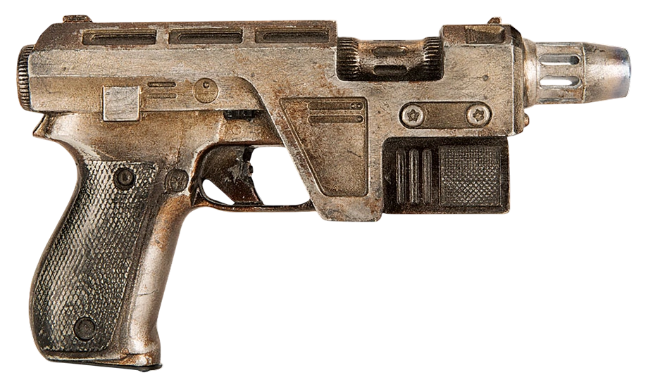

  2. Blaster and Holster:
    Blaster: https://vignette.wikia.nocookie.net/starwars/images/9/9b/Glie-44_blaster_pistol.png/revision/latest?cb=20160710050337
    (Source: Star Wars: The Force Awakens Visual Dictionary)
    Holster: https://image.ibb.co/ibU44R/Resistance_Pilot_Costume_Holster_January29_2018_03.jpg
    (Source: Blue Banshee Leader)
    Required Details:
    • Blaster
      • Glie-44 blaster with accurate detailing.
      • Aluminum-colored body.
      • Metallic silver barrel tip and chamber.
      • The tip has a series of pill-shaped cuts in it. The cuts are hollow and go all the way through the tip.
      • Flat black handle grips.
      • Flat black or gunmetal cap on the back end of the blaster.
      • Flat black ammunition clip.
      • Flat black trigger and trigger guard.
      • The blaster must be paired with a holster.
      Other Details:
      The Hasbro Poe Dameron Nerf GlowStrike Blaster is acceptable but the screw holes must be filled in, and the "STAR WARS" text must be sanded off. In the case of using this blaster, the pill-shaped cuts on the tip may be painted black instead of cutting them through.
